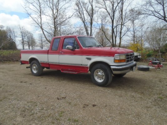

not sure if this helps but 96/97 f series are job specific. econolines are different , had a 2003 e350 and I understood all the e series with the 7.3 powerstroke were the same. my e350 had a trailer tow tune and installed and I lost my tuner but i am keeping all the computers anyhow.
