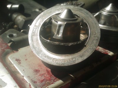

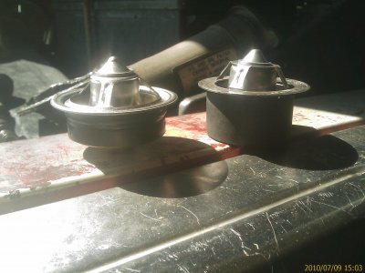

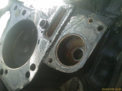

This is what I found when I opened up the thermostat housing, a broken thermostat from china, the ring that holds it in place was broke clear off and causing the stat to plug up the hole. Symtoms included are:
Temperature rising under Load, Radiator cool on one side, lower rad hose cooler then usual. upper rad hose hot.
Not enough coolant flow caused be jobber thermostat.

I see the pictures just fine. Also I'd say a overly hot upper rad hose and overly cool lower one along with overly higher core temperature on the passenger side than on the driver side of the rad is an indicator of partially clogged radiator - that is if the differences are extreme, as due to the hoses arrangement and the fact it's a diesel engine the upper passenger-side corner of the rad will always be noticeably hotter than the lower driver-side corner. Also the engine will run hotter when under load, if you have a pyrometer you'll notice the combustion temperatures inside the cylinders greatly increases when the load on the engine is high, this extra heat transfers to the coolant and even tho the radiator is quite good from the factory there's only so much it can do - which is why some members here who tow heavy have gone with some custom-built aluminum monsters in place of the factory rads.
All this said, that T-stat is effed pretty good, the consensus is that a replacement should only be had from a Ford or an IHC dealer...

If you look at the picture of the chineese stat, you'll see its much deeper, that alone will restrict flow in my opinion. Flow is very important. So whatever stat you use, Look at the depth and compare with these photo's.
