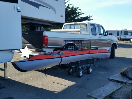

this is towing a 6-7 k 5er...
edit
to blackdawg
Cuz pistons start to melt at around 1200*????
franklin2
My 93 is bone stock, has sub 60k factory, it got hot once going up i5 in Washington (BIG LONG Grade) @8.5* bumping it back to 9.5 fixed it (this was with the pos faccett e pump)wich I attributed to lack of fuel flow as a hindering factor.
and this week in norcal on a modest grade of 80* weather
both times it hit 230*
No failings anywhere to be noted, seems she got pissy @9.5 for the first time this week.... With a holley red, could be the hydraulic advance issue on the ip perhaps...
just adding to the database here guys.
if this junk ever comes apart I'm doing the 6.9 mod!
