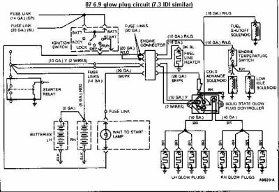

The battery cables are relatively new, and corrosion free. It seems that the previous owner replaced them before I bought the truck. but I did have to replace one of the negative battery terminals because the terminal was too loose on the battery. the truck starts just fine when the batteries are charged, its just that the alternator is not putting out more than 12.7 volts at idle. and even less if I have the AC or lights going. I should mention now that if the engine is revved up to above 1200 rpm then I can usually get around 12.9 - 13.2 volts, but revving any more will not make the number climb higher. I should note that even after testing all these wires, even though none of them show exsessive resistance, the truck is not without its strange electrical gremlins. Sometimes while driving at night the headlights will flicker on and off and I have to stop on the brights switch to fix it. The glow plug system has never worked quite right either, as I tested each glow plug, and all of them tested good, but the system still refuses to do anything but make that clicking noise when i turn the key. Strangely enough, taking the truck through a car wash during winter (doesn't matter if it's freezing conditions) will make the plugs work as intended for a couple days. So i had suspected some sort of bad ground for that, sorry for the wall of text, I'm just trying to give as much info as possible about the problem.

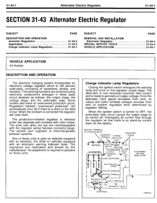

Firstly, your voltage regulator case has to have a good ground, screwed securely to the body/chassis.
The wires connected to the VR have to be clean, no corrosion.
The green wire from the in cab VM to the alternator has to have a good clean connection at the Alt.
The 12.3 to 12.7 voltage is typical at idle speed.
At 1200+ RPM, after a start, the Alt. should put out 14.5 to 14.7 for just a minute or two, then reduce to ~13.3. The in cab (dash) VM is not very accurate, actual voltage should be measured with a Digital VOM.
All things aside, you could switch to a 3G Alt that has an internal voltage regulator.
Those damn external VR are known to give a person a lot of troubles. With your key OFF, check it for any voltage on all connections, there should be NONE.
