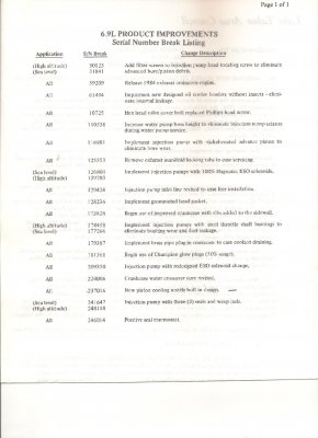

Check the block number at the top front of block and compare to the list. The later blocks have bolt in piston cooling nozzles, the earlier ones are press in, and not as simple to deal with. The earlier blocks have been known to crack in the area of the block heater if the heater is used when the block is cold. As far as price goes, it can be all over, depending on condition, miles, etc. If you have room, a complete truck may be cheaper overall with all the spare parts.

Sadly the early blocks have some issues as already posted but that is not always a deal breaker. If you know of the early block issues and do not use the block heater you probably can run fine. but you never know. they also have pressed in oil cooling jets under the cylinders spraying oil up under the pistons. the later idi block have a bolt in oil oil cooling jets. Mush better block too. Many on the idi engines are completely interchangeable internals. About the oily item that wont swap is the pistons from the 6.9 to 7.3 or the 7.3 to the 7.3 turbo engine.

I don't think the block is really much different beyond the reinforcing around the block heater port.
However, the press in oil jets is a major issue - price out a set before putting any effort into an early block. There's no effective way to remove and reuse them, so you're pretty much forced to buy new. 8 years back or so when I did mine the cheapest I could find them was $40 or so each... for a quarter sized oil jet. :puke: That was a nasty shock to find out. Cost me more for those bloody little things than it did to have the crank ground and a full new set of bearings.

So you can't use the block heater on the 85 blocks? Thought it was only the 83-84 that had that problem.

IIRC the split is early 85, somewhere around a Jan 85 build date. Both my 85s were dec 84 build and had IIRC engine sn below the cuttoff.
I believe the 'sidewall ribs' change at sn 173xxx listed above is the block heater fix, so if your engine sn is above that you should be good.
