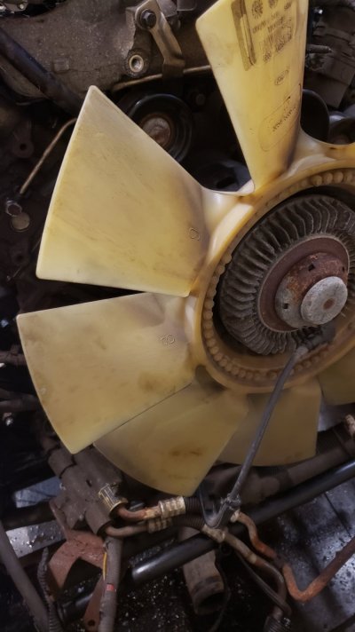

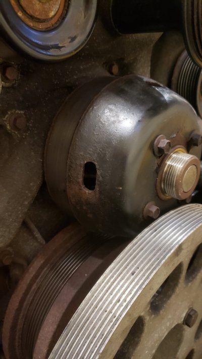

Just because its a serpentine belt doesn't make it necessarily reverse rotation. It depends if the waterpump pulley is smooth or has grooves for the serpentine belt. If the waterpump/fan pulley has grooves, then the fan and waterpump turn the same direction as the crank. If the pulley is smooth with no grooves, then it does turn opposite direction compared to the crankshaft.
77 F-250
Mar 12, 2018
26
New Hampshire
6.0 pulley is smooth. Fan rotation is CCW looking at the engine. About 23.5" in diameter.
