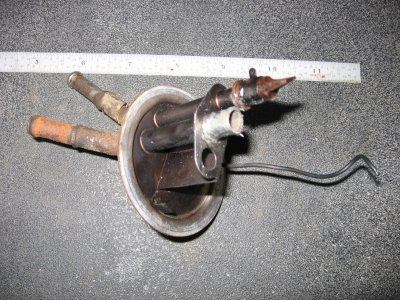

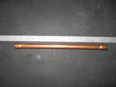

LMC as part of a bigger order. The tank itself is nothing special - made in Taiwan... Here's a picture of the pickup extension that's part of the kit and the original sending unit prior to soldering it back together.

The tank came with the parts to extend the fuel sender/pickup, 4 new longer bolts and spacers. The upper and lower straps are extra. I ordered both but frankly, you don't need the upper ones if the ones you have are in good shape. The lower ones on mine were rusty so I replaced them. Each set of straps is $20.
