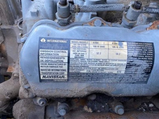

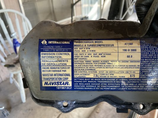

So not sure if anyone has attempted this specifically. I was directed here form the diesel guys over on Reddit.
Have a feb/94 F350 7.3 idi turbo diesel, automatic (blue tag photo). Dad say the block is no good. So we found a 92 F250 7.3 idi (non turbo) manual trans (black tag photo). We’re just planing to take the block from the 250 and throw it in the 350 bolt on our turbo and let it rip.
Reddit recommended we take the flywheel as well off the donor. Is this all I need to consider. Do y’all think this will work?
I see Navistar used the same 7.3 idi from like 86-94 and just in 93-94 added on a turbo option. So I figure it’ll work. Let me know. We’re gonna pull the engine this week I think.

lotzagoodstuff
May 19, 2007
2,728
Carmel, IN
Dabbling Madman: Please confirm that you are just doing a complete engine swap as your “taking the block from the 250” verbiage suggests you are swapping the internals.
Second, what’s the diagnosis on current “bad block” engine?
Lastly, if you fill out your signature with the details on your truck, it will help other members in answering your questions by knowing a little more about what year/model/etc you are working on.
Again, welcome aboard and good luck on what it sounds like should be a pretty straightforward engine swap.
