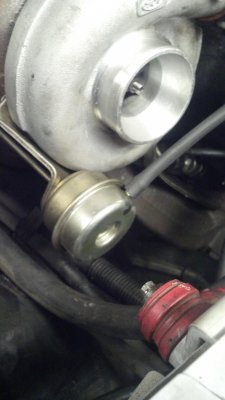

This truck does have a pressure reference line from the rear bolt in the intake hat to the wast gate.

I have never seen a boost referenced turbo on a stock 6.5L. There are also no replacement turbos with that description. Get a boost gauge and check the boost. I doubt you needed a turbo, I have 2 w/ over 300K miles on them and they still boost just fine. I replaced seals in one and rebuilt the other in under an hour.

Well you are right, 93 never had boost reference waist gate. Why this was done I'm not sure, but it's there. I am wondering if it is a actuator from a 95 or a custom unit. there is a boost gauge in the truck and when I drive it tomorrow I will do some testing.

Heres some pictures of the Turbo

Turbo pictures
