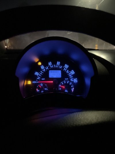

Yeah I have a pretty good scanner. It’s throwing a code for the mass airflow sensor and it’s showing all the symptoms of one as well. It bogs a bunch from a start and doesn’t sound like it loves starting when it’s cold.

I went to the junkyard to get something With my buddy and I saw about 30 of these stupid beetles so I grabbed 6 MAF sensors lol. I just need to drive it now to see if the light comes on. It runs better. Need to smog it
