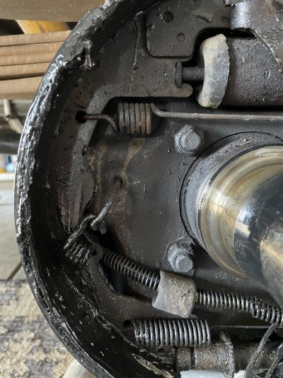

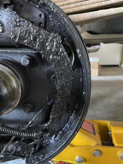

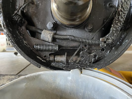

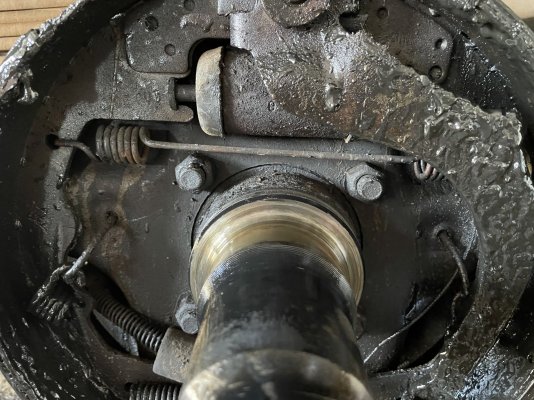

In my opinion it was too hot to be inside the cab messing with weatherstripping. So I decided to do my brakes. I discovered once I cleaned everything that the shoes still had a good amount of meat on them (and Oreilly’s sent me the wrong shoes) so I just cleaned it, put new hardware in, and then I did the wheel bearings and seals. I don’t think that the brake adjusters have ever worked because good lord does this thing stop on an quarter now… not a dime, but it was like a dollar before. Tomorrow I’ll do the differential fluid and then hopefully once it cools off I’ll finish the weatherstripping. I think I said it before but I’m planning to go on a pretty long trip soon so it’s bumped me into gear. Glad I’m doing all this. On the 13th im getting the a/c all charged up with the last of the r12 we have and then I think I’ll get it balanced and aligned.

What's with all the sludge? Should be dry and powdery in there... that greasy junk at some point will lock up the tail end super easy and is quite dangerous. So you may be able to reuse the pads for a while but don't be surprised when they lock up on dry pavement like crazy. Been there twice myself.

Oh I should’ve clarified, those pics are from before I did anything. The seal was in bad shape. It’s all nice and clean in there now.

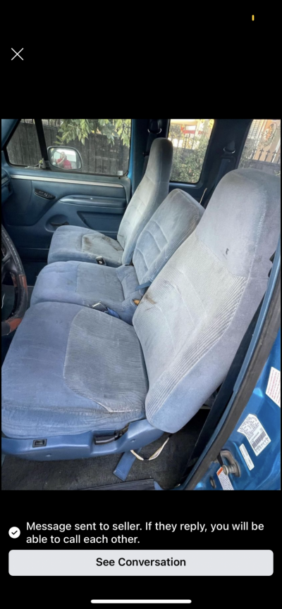

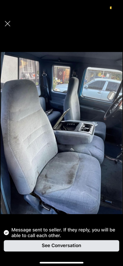

Very excited, gonna go look at these after work. If the stains aren’t from poop I’ll buy it.
For some reason, even though everything else on my truck is from other trucks, I’ve been really picky on getting used interior stuff just because I don’t know how yucky the previous people are. Probably pretty pointless

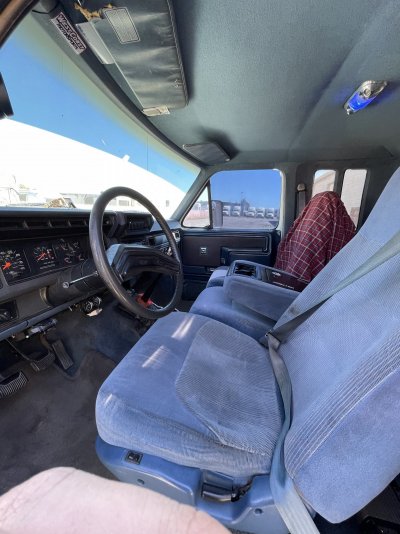

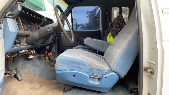

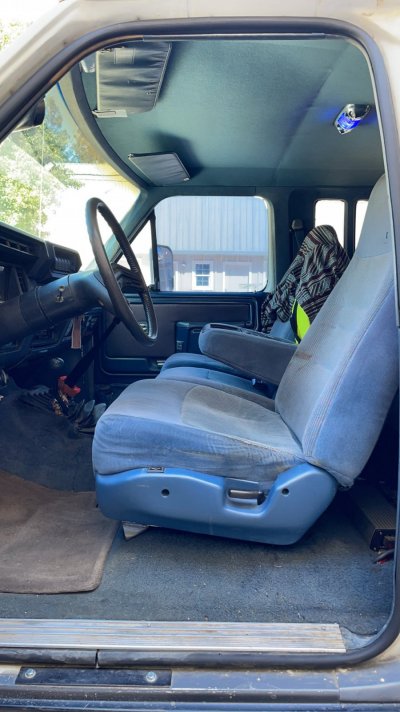

So I was told on multiple occasions that if you get a 40/20/40 seat from an extended cab it would bolt into an 86 extended cab no problem. Well that was false. Yes the floors are the same, but the bolt holes are different AND (the biggest thing for me) the damn seat had damn near a 45 degree angle. I’m not sure why. I’m guessing the 95 cab had some raised spots in the rear for the seat to sit on. Anyways, I ended up cutting an inch out of the drivers side seat brackets and that helped tremendously and I can now say it was worth it. The passenger side has a mild angle but I’m not sure if it’s enough for me to take it out and do some more fabrimucation. The lady will be the one who tells me I guess. Anyways. The cup holders are nice, I like having the center seat. It reminds me of when I was little my stepdad had an obs work truck and I’d ride in the middle seat. Love it.
