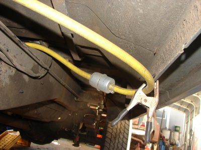

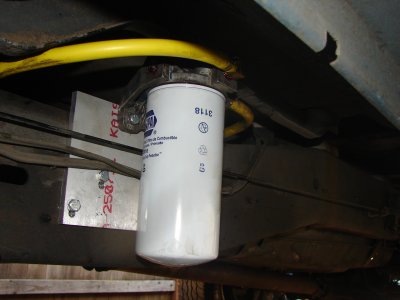

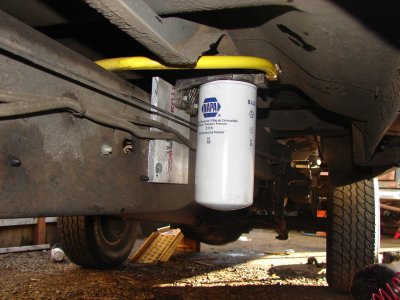

I have been fighting a dirty front tank and the little filter wasnt cutting it even when new.:backoff
So today I put on a detroit diesel primary, designed for suction, 30 micron and 5.75 thru my buddys napa acct. ;Sweet
This should last longer than the 3/8 inline.
The suck part is I found my right rear has gear lube shining up the tire, of course the brakes are 6 months old.-cuss-cuss
