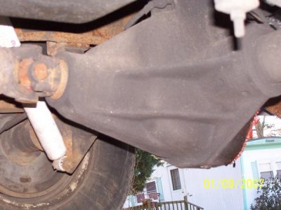

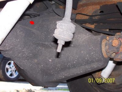

i dont have a picture of it but if yours is a dana 70 it should have 70 or 70HD stamped on the housing by the pinion somewhere,mine does.
rich-
that's what's cast onto the housing. I thought it came out of a dodge since it was a dana. I've yet to see a tone ring dana for the f250/350's of the pre'99 vintage in a ford. only sterlings.

actually here i went out and got a couple pictures for you.the red dot is where i believe it said 70HD on it.
