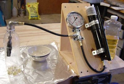

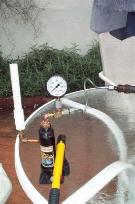

I found the info over at mercedesshop a while back and built one of the bottle jack style. Drilling and tapping (3/4" npt) the cap could be a problem for some, but I had a friend who owns an industrial machine shop do it for me.
If I build another one it will be the grease gun style. It looks like it should be a lot easier. I would also spend a little extra for a better gauge with a needle that shows what your maximum pressure was during a test.
c&p:
"Credit goes out to OLD300D who sent me this a while ago.
Pop tester parts list
I bought all the parts from www.McMaster.com
1 8803T51 Bottle Jack ($12.74)
1 4000K763 3000psi gauge, 3/4" NPT ($10.04)
1 5269K311 Metric fitting, 1/8" NPT to 6mm tube ($3.12)
1 50925K197 Steel T fitting, 1/4" NPT, MxFxF ($4.27)
1 4513K341 Hex bushing, 1/4" NPT to 1/8" NPT ($0.85)
1 4513K347 Hex bushing, 3/4" NPT to 1/2" NPT ($1.18)
1 4513K344 Hex bushing, 1/2" NPT to 1/4" NPT ($0.95)
The jack must be disassembled, and the pressure relief in the cylinder plugged. I tapped it, JB welded a set screw into it, then ground it flat. Remove the seal from the top nut and tap it 3/4" NPT. I JB welded the bushing into this thread as well. The gauge and 1/8" NPT bushing thread into the T, the injector line is cut and is fitted into the metric tube adapter. I also tapped and fit the bottle jack for a funnel into the reservoir to keep fluid in the cylinder, as quite a bit is pumped out as you test injectors. I used ATF and Marvel mystery oil to fill the tester."
The 5269K311 Metric fitting, 1/8" NPT to 6mm tube fitting is for mercedes injectors. It is probably a different size for a ford.

Guys.... These are great ideas of how to test an injector but... Please install a standard fuel filter BEFORE the fuel gets pumped thru a possible good injector. If ANY crap,,, And I mean any debris gets pumped into an injector its pretty much shot to .... Well its junk. Its really hard to clean out any trash that hangs up the pintle or plugs the hole up. Even using a spent fuel fliter will be better than nothing.

I was thinking of making one using a hand operated hydraulic pump simular to the ones used on a porta power.I picked a pump up at a yard sale some time ago-brand new -light weight made of aluminum-2500 psi.
By the way did you give ur wife back her ceral ***** yet ? :backoff LOL :rotflmao

Exactly! The grease gun type is easier because of the drilling and tapping.
Agreed! Also be sure to thoroughly flush out the tester before use. It doesn't take much to clog an injector.
I had to reopen and clean three of the first set of five that I did.
:rotflmao That's great, I didn't even notice the bowl in the picture before. LOL
The picture is one that I got from from a thread at mercedesshop. I can't take a picture of mine because I broke the wifes digital camera and haven't given it back to her yet. Maybe she won't need it soon and I can get her a new one for christmas!
