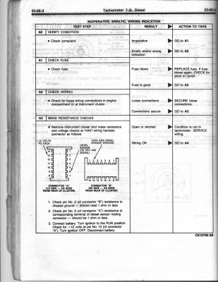

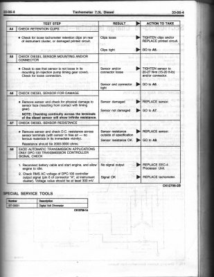

Maybe this will help troubleshoot your problem. These are from an 89 Ford Manual, but should be close. Corroded connectors are usually the problem.

Sorry, I forgot to add my truck in my signature... updated now.
Those pages look like they will help quite a bit, thanks!

Well I made it through the testing procedures from the pages that you posted on here. I am thinking it is the computer that is the issue. I am wondering how common this is or if there is anymore test's on the computer itself to verify. My other question is when I check for resistance from the tach sensor connection (tach unhooked and testing at the truck wiring only) I get very little resistance to ground on either terminal of the connector. Shouldn't one side be complete resistance? However once I unplug the computer at the firewall then I do get resistance.
Any other thoughts before I start looking for a computer?
