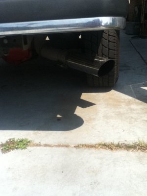

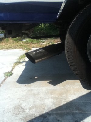

The only problem I have with my dynomax tail pipe is that the hanger it has has the pipe sitting wayyy to low.

Any pics that anybody has of the dynomax tailpipe would be great.;Sweet
