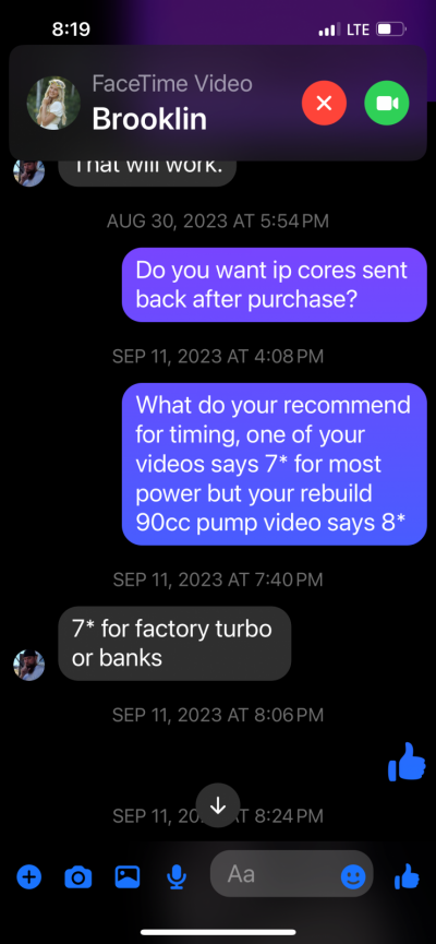

I always set my timing to 7* per recommendations from r and d
