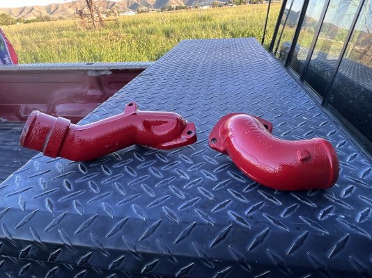

This is the color it will be I did the water necks for fun

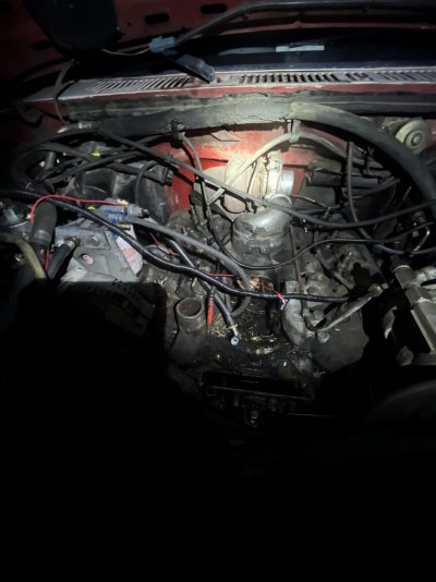

I ended up going for the remove ip route, needed to swap my injecotrs, gp’s, and harness from my old motor so having all the lines gone made it a breeze
Not sure what all the fuss is about those crazy 9/16 wrenches for ip’s is I just had to grind the sides a 1/4” on each side and I was good to go
Since I never put the grille etc in from the motor swap yet I’ll just yank the rad and condenser for easier access
I also forgot the petcock existed on the rad, boy does that make a world of difference on saving coolant and not drenching yourself
I have an r and d cam I was going to save for my 7.3 but it’s tempting to slap it in now thoughts for this non studded 6.9?

It's your call. Studs probably don't matter at all with a cam swap. It's not adding any boost.
