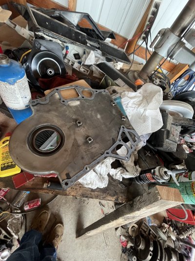

I had a spare timing cover so I’m decided to press the new seal and tack up the gaskets now
I now have a press so this is my first time using it for a seal makes me feel a lot better than hammering them in

Man I wonder where that came from lol
I siliconed the two paper gaskets when I had my old man's engine apart. So far no leaks still.
