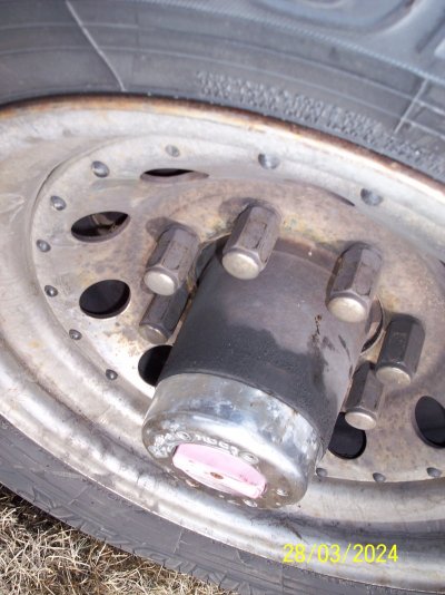

Today was eventful. First I took my little black monster to his vet appointment so that he'll be singing soprano. After work, I put the 4th new tire on. I put on the good, used vacuum pump that I found on the engine. It works GREAT by the way. Then I topped off the oil so that I won't have to worry about that Saturday morning. I took off the passenger's side locking hub because it was letting grease seep out. I just took another one that I had saved and switched them out. Finally, I lowered the air pressure in the passenger's side front tire. I looked at the door sticker last night and it said 51PSI in the front tires, so I put 50 in the one I mounted today. I dropped the other one from 55PSI down to 50PSI so I should be good there. After I dot home, the lockout hub was still all shiny so I guess that the seal's in better shape than the one I took off.

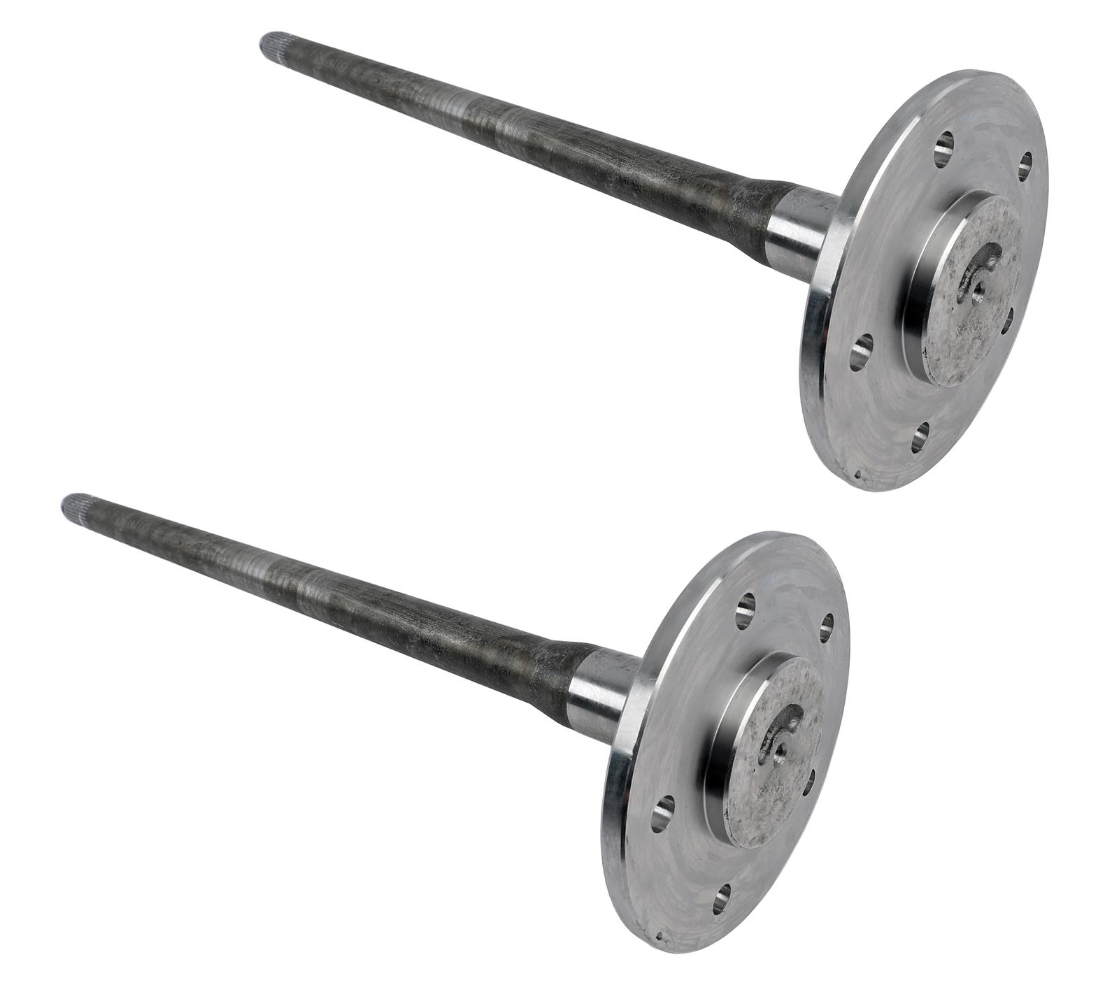

The bearing that is refered to, is the outer alxe bearings and those are in the two sizes. My f100 has a 9in with the big bearings and snaped a 28 spline one, so dug and found that a bronco had the right size one on the passenger side thats 31 spline. So called and talked with the pepole at this place to get two in the length I need, and also got a full spool to put in the 3rd member. Oh yea and the axle length is from that bearing plate to the end of the splines, length from plate out is determined by 10 or 11 in drum.
I pulled one of the shafts tonight. Interesting it was 28 spline. There was a number of generational changes in 71,72,73 for ford it seems like a toss up whether you got a 9” or a 9 3/8”. This site is a good resource for anyone interested: http://www.fordification.com/tech/rearends_ford09.htm
My rear end turned out to be:
28 spline
11 inch drum
Big bearing (3.15”)
28” shaft on drivers side
I’m going to pull the other side now, remove the 9” third member and do some measurements, I read on the carrier side of the housing it may not swap direct if the tube is too narrow and I want to measure. Then I’ll call Tom’s off-road.

Im not sure that is the right place to mesure lenght, but that was where the guy I talked to wanted measurement. What would be the length be from end of spline to the inside of the axle flange and are they the same size for both sides?

The passenger side is longer. Referencing how they measure, passenger is 30.5”. Spline ends to inner axle flanges is circa 29” and 32”

@hacked89 , Im trying to recall how I came about picking these axles out. What Im getting dusting off the cow webs, it is that the 9in durm sizes makes things squirly with the two bearings. I have the narrow 2in wide 11in drums on the rear and not the 3in ones, think got ones for with a 10 in drum.
The marking for the axle part number surved for a photo shoot, and this is the I got for mine. I have the recite somewhere but would have to did for it.
That lead back to this and what leads me to that concussion, I have the same one on both sides.
9in axle shaft

Yep and I have 3” drum

I think the longer one might be found on a 1974-86 f150 or e150
As for the sorter one, I come up with maybe one off a 1966-75 bronco but durm with is less. So the alxe flage to retainer flange offset may be wrong, rear shoes are 10X2.56 or 11x1.75. You can call toms and get more info on the lengths and offset of the one off this vehicle.
