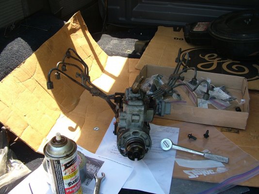

That hard to reach nut in on a stud coming out of the rear of the gear tower, clamping the IP in place when you time it. What I'm talking about is on the IP itself, on the forward facing section. You can see it in this picture. It's perfectly square, sticking out a bit.
