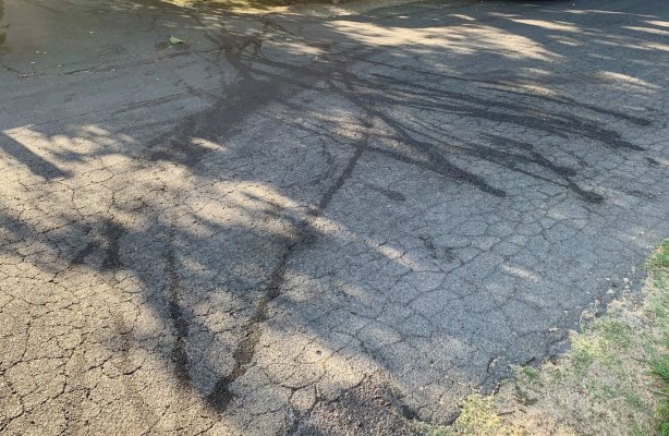

Update - plus one year. its happened twice since, and this third time yesterday - I think I have the pattern. 1) Long five hour drive, bed full of tools, 6K in trailer+cargo. 2) it sits for 10-20 minutes on arrival. 3) it is used to "walk" a trailer into a tight spot 100ft down a narrow driveway. Which means alternating between reverse and drive - 10 to 20 times. Having put almost 15K miles on it since this post last year - if there were a problem with drive... the transmission would have drained all its ATF and expired long ago.
So I conclude - it leaks like a sieve when its hot and put into reverse. Question is - what to do about it. Photo of the street is included... Nothing where it was parked prior to going into reverse. There are another - two - long streaks down the driveway, and two foot wide puddles. Drove it to the shop this morning - and absolutely nothing came out of it.
@Jesus Freak noted it would happen again under load, and get worse - and here is the evidence! Only thing we didn't know then - is that it happens when in reverse. Most previous responses were - front seal.
At this point I figure my choices are - have the front seal done and see what happens, or just replace it. I'd appreciate any opinions before I dive in on this one. Thank you everyone.

That's some fine scientific study. But replacing the front seal should do it. The only hitch in the giddy up will be if the torque converter has any maring on the shaft but I really doubt it would.
