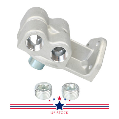

I built a regulate high pressure system for the same amount of money it costed me to install the garbage 40222 from facet.
I would never suggest that anyone goes to a low pressure pump.
Source your own parts and build your own high pressure system, you could put a whole system together for around $250 using
a Walbro high pressure pump, Holley bypass regulator, filter heads, and filters.

Ooh yeller filter$$$
Part # for the filter heads?
