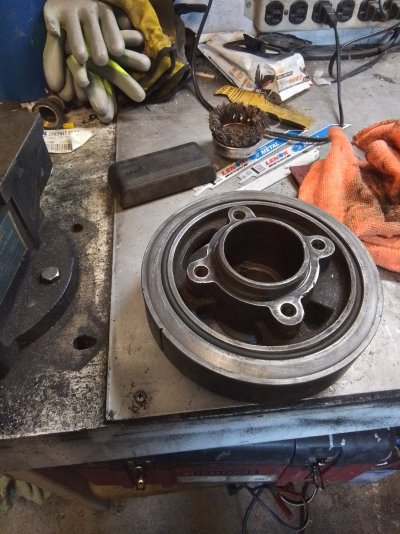

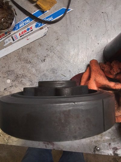

Jun 17, 2023 #1 Kdo58 Full Access Member Joined Sep 8, 2021 Posts 202 Reaction score 202 Location Puyallup washington I am cleaning it up to install a speedy sleeve, and notice the rubber is sticking out farther on one side. Attachments 20230617_084542.jpg 391.1 KB · Views: 14 20230617_084609.jpg 383.6 KB · Views: 13
Jun 17, 2023 #2 Nero HD Diesel nut Joined Jan 3, 2022 Posts 2,494 Reaction score 2,554 Location OR Looks like the outer ring has slipped a little, plus the rubber has a few dry rot spots. I'd change it.
