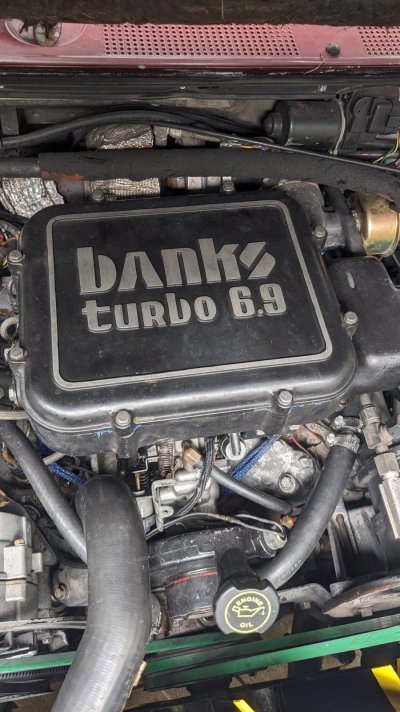

Hello everyone, I'm curious to know if anyone had done something in the way of replacing the old banks turbo air filter box with something else? Other than just slapping a cone filter on.
It looks nice, but it covers the whole top of the engine, is rather cumbersome to remove to work on things, and worst of all, you have to unscrew 8 dang bolts just to check the air filter! Not to mention fighting the lid back on just right without crushing the air filter... Of which k&n is the only option as it's custom made for this kit. While it allows more air flow, id rather a filter that stops more dust.

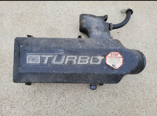

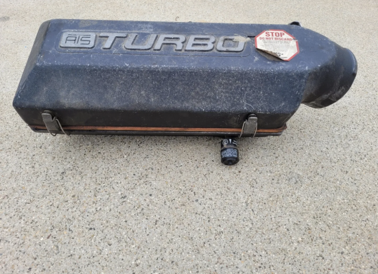

I like the look of the old ats filter housing, not as big and opens easily with latches. I wonder if there would be a way to make it work with the banks setup. If I could get ahold of one I would try to find a way to adapt it

I have one of those Banks Air Boxe`s also on the 85.
I like you searched and searched for a paper filter that would replace the K&N one, a Banks only Filter.
Bought one from Summit Racing, but came from banks. Think it was $51.
Still new in the box.
The one I took out was really bent and scrunched, no way it could have filtered out anything.
It`s sort of a feel good filter. I think I had to buy one of the elbo hoses, think to the rear.

Yup, it's a banks only part. I ordered mine directly from banks, about $50.
And yes @IDIBRONCO , you are partly correct. There are two different versions of the big box that I know of, one the intake hat is a part of it and the other they are two separate pieces. Mine is two separate pieces.

For that reason I'm starting to lean to trying to find a way to make the early rectangular ats filter box work... anyone have one laying around they'd be willing to sell? Haha

I had the early box like in your picture on my 93 with the 088 box. When I ran it hard my filter minder would set to restriction. I had to cut another round hole in the air box to get enough air flow to keep the filter minder from showing air restriction. Also that box uses a special k&n filter (it crosses over to an early model Porsche) they were hard to find at a reasonable price at the time. I’d look for other alternatives.

From what I could find it's a 1977 Porsche 911. If that's correct both Baldwin and K&N make it and they are available through Napa and on Amazon. The k&n is kinda high but the Baldwin is about $35.
But the restriction thing is odd, but I wouldn't be against getting one to experiment with and possibly modify if air restriction became an issue
