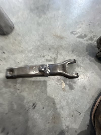

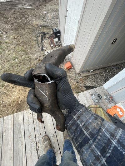

T-19 fork is obsolete trust me I spent hours researching, asking Facebook and here, I’ve seen some for sale but they are zf5 labeled as t-19
had to weld mine up Becuase it broke in half
they weld really nice it’s just stamped steel so I would recommend welding it up back to shape
I didn’t feel comfortable doing this with flux core so I went to my buddies house and migged it
Unless you buy a used one which seem to be far and few
It seems they don’t grease throw out bearing very good I’ve had premature failure twice so now I pack them real good and stopped having issues
