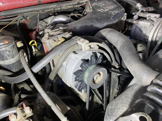

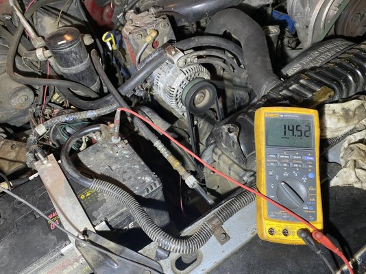

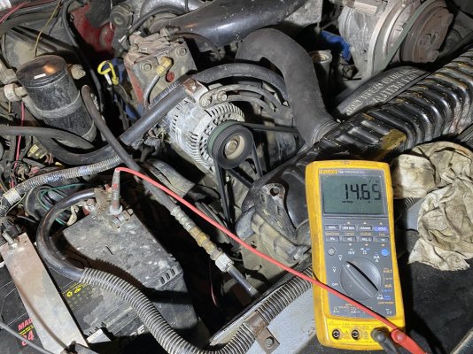

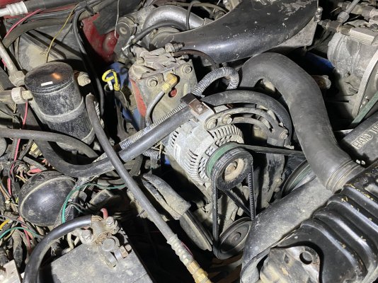

I don’t even remember when I acquired this, but apparently I had a complete kit ready to go to upgrade the alternator to a 3G. Even had the wiring harness with fusible links still in it. Took about three hours because the pulley I have is apparently loose. I eventually found some shim stock to take up the slack and recenter it. The alternator is dimensionally smaller than the factory alternator, so I’ll probably swap to a shorter belt later on. Another bonus, since these belts are known to flop even when properly adjusted. The vacuum pump belt seems to be fine as is.
You might try loosening the curved bar that the alternator tightens to and rotate it more to the passenger side. I'm running stock length belts with 3g on my 89 E350 and it's nowhere near the end of the curved bar.
edit: oh it looks like you did. Well i checked mine just now and it's similar to yours actually. but it's plenty tight. I like fleet runner belts, very tough.

Still running the original size belt with no problems and plenty of room to tighten on the curved bracket.

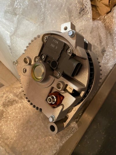

I bought a 3G alternator when someone here posted a deal on them a while ago. I figured that I'll install it when my current one fails.
Is there any reason that I should switch it sooner? What is the advantage to 3G? And is there a wiring conversion kit available or do I need to make one?

I just opened the box (that got delivered a year ago?). Here's what I've got.
I assume what's in the truck is OEM.

There's no kit needed. All you have to do is to cut the wires that go to your current voltage regulator and splice them onto the ones that come off of the 3G regulator. It's not to hard to do.
You do need the harnesses that plugs into a 3g alternator
