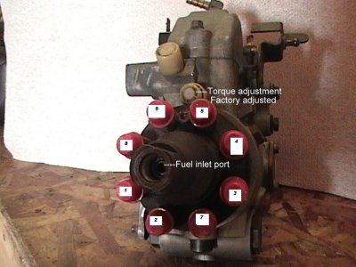

now hold on i thought that the one facing straight off of the pump was the governer adjustment that you werent supposed to touch and the one at an offset was the torque screw. that picture seems to have them labled backwards.
338
As far as I know that is the torque screw. This pix shows in the lower right corner the other screw, which is just a plug, hard to see, but it don't touch anything. I've got 4 IP's and will check to see if any are different from the one shown here.

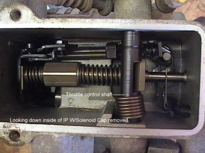

now that nut that has the springs on either side of it inside the top cover, does anyone know what that does because i went to help someone with one of these trucks and he had turned that nut for some reason and I just had him put it back to stock location because niether of us knew what it did

so that picture is labelling the correct torque screw? cause i thought it was the one higher up on the pump, i turned that one up (it didnt make any power difference for me) so maybe it is the lower one?
