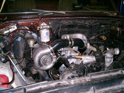

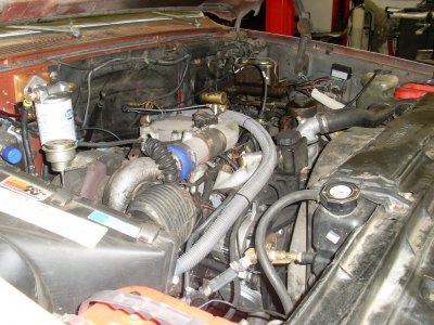

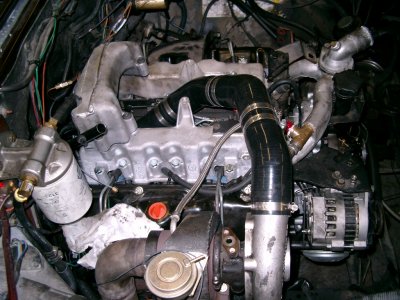

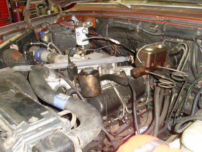

haven't had an issue yet;Sweet
Looks sweet..=)
I have had 3 cranks and 2 block broke on my 6.2 so im always driving around nervous..:eek:
i have tryed to find a red block or a 599 but it seams impossible here in sweden.
the engine i have now is total rebuild 699 block, but you never now..;Really
im gonna fabricate my own girdle, maby then they will not blow up..=)
nice... you yank that one from a van towcat? what did you do with the under side of the intake plenum to hook up your silicone hose? do you see any difference compared to a normal f-code 6.5l intake? that is a great use for the center mount heads.... once again great job for thinking outside the box....;Sweet
