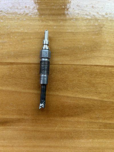

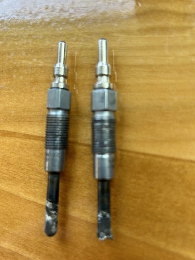

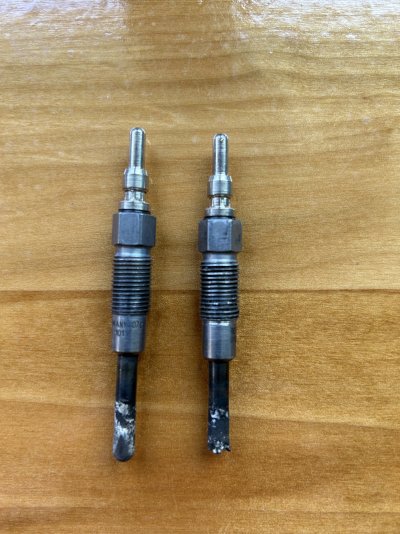

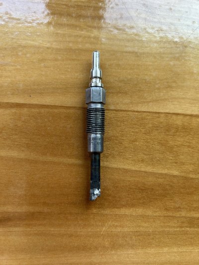

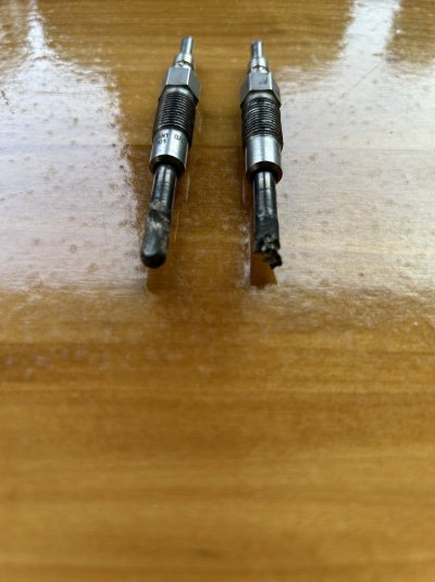

Sorry for the delayed responses. I have a very busy and random schedule. So it’s difficult for me to get on the forum. Here are the pictures of the two glow plugs I have left from the bad batch. One is the infamous broken one which I’ll probably keep as a reminder of crappy products and the other I was using to test the hardness of the tip. I was just curious. So ignore the dent on the end of it. This one is actually in decent shape compared to the white crusty stuff and swollen ends the others had. I believe I threw the others away already.

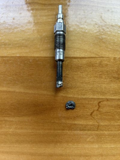

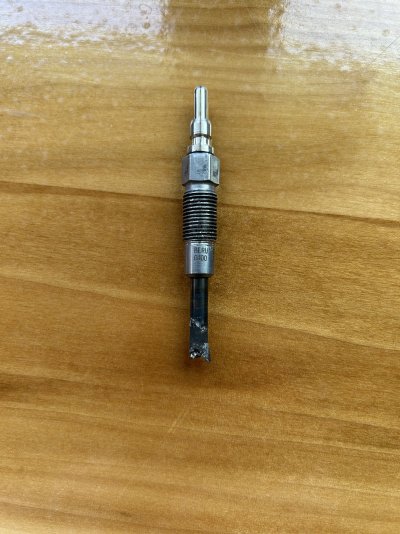

These do appear to me to have the correct markings as well as the correct crimp. But I’m no expert. The packaging they came in looked legit. Here’s a picture of the piece of the tip I dug out of the top of my piston.

Those do look to be genuine motorcraft beru plugs to me.
