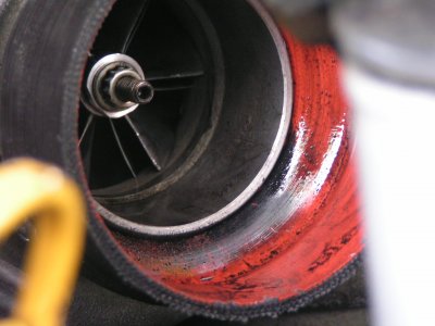

OK kids.... bad news....... So as i said this morning, I checked it and there was no oil whatsoever on the stick..... That being said I called up my buddy at the shop and he said to get some oil in and bring it in.... I did just that... I bought 2 gallons of rotellata and put 3.5 quarts in and drove it down to him..... We let the truck sit a bit then checked the oil, STILL NOTHING!..... we proceeded to have to add another 4 quarts before it was reading full..... Fired it up let it run for a while, checked the oil again, and damnit if there wasn't less in there than we had just a lil while ago!!!!! Heres the bad news...... we pulled the air intake off the turbo..... (mind you I had done that like 6 weeks ago for the GP's and it was okay) The dayum turbo had oil all up in it....... thus with the diagnosis of needing a turbo rebuild..... can we say CRAP!!!!!!!!!!!!!!!!!! And still trucks blowing no smoke........ Anyone have a turbo????? lol

Okay guys..... So a friend of mine came over and we tore off the air intake again, cause he had called up evergreen turbo here in ocala to see what was involved with a rebuild and whatnot...... so upon taking it off..... he wasn't convinced it was the turbo but we fired it up and thought there was an excessive amount of blow by, so I made a video of it..... Let me know what ya'll think....... I'm lost..... :dunno

If a rebuild is needed its not expensive but... Just getting that thing off the motor is a pain... Banks is much easier to remove... Just make sure the wheel has not hit the housing and it will be a cheap rebuild. Also, have it balanced. These turbos will turn as much as 130,000 rpm. Thats why the air going into the motor is so hot after about 13 lbs of boost.

that turbo doesnt look to bad but i cant hear see touch it the oil that is there looks like blowby oil have u checked your cooling system for oil

What and where is this?? Also..... I had yet one more knowledgeable friend look at the truck..... and agreed on the turbo thing.... there is oil under the turbo also, not tons but enough..... and some dripped down by the tranny and whatnot.... also not "leaking" but probly under pressure it is getting pushed out, no oil in the tailpipe.....
