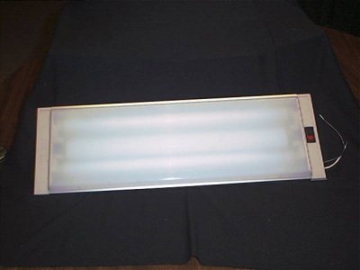

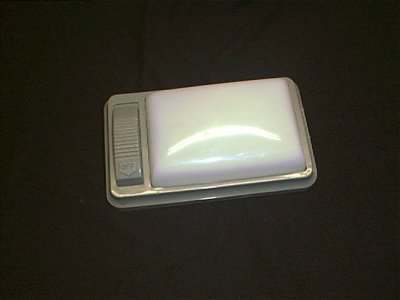

Looks like you guys did a hell'va good job on it so far. So Spencer is still in business, I bought quite a few parts from them, when in the RV business. It you need some 12VDC lites for the inside, let me know by PM. I'll see if I have pics yet. They would be 30 watt fluorescent twin bulbs. Those retail for $54, I'd sell for $20, I paid $30 for them, they are flush mount. The small ones 2nd pic is a single bulb, $2, they retail for $6.50. Plus shipping.
