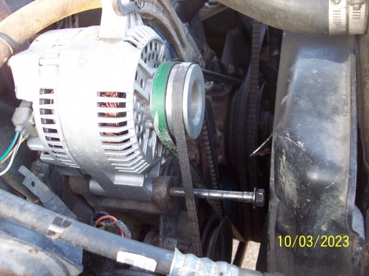

On my recent trip to Texas, I checked the oil at a gas station in Lampassas, TX. I about flipped out when I saw this. I wasn't going to try to fix this at a busy gas station so I drove to a closed (after hours) tire repair shop at the north end of town and was able to loosen the upper bolt and wiggle the pivot bolt back and tighten it up. I know the solution. Blue Loc Tite, or red if I don't have any blue on hand. This has happened 4 or 5 times in the last few years and it's getting old. I'm just looking for serious reasons why it would keep happening because I've never even heard of anyone else having this issue.

Gonna be checking mine now. ;-)
Good on ya for catching it. Some things slip by when you're tired.

I've had that happen before. Ran the bolt back in and retorqued, hasn't happened since then. Wonder if it was just an initial tightening issue.

I had that happen. I didn`t notice it but a friend did. Was sticking out about an inch. Retightened and all has been good.

I had the vacuum pump just about fall off a few weeks back when I was up in Reno. Lower bolt fell out and was hanging on upper one and belt went bu by.

If the Alt Bolt fall`s out, the fan flipping it around will get your attention. At least the top bolt will hold the Alt, but you might lose the Vac Pump belt... it will be a fun time...

For whatever it means to you, without tension or other means, bolts work themselves out due to vibration. For my alternator, that hole is a bit of an interference fit so it can’t undo itself. For yours, you might want to throw a lock washer.
