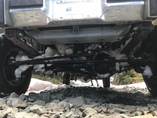

It's now been a year since the 4wd conversion and it looks like my truck will be losing it's pavement queen status. Some friends and family are also catching the bug for mild off-roading so I'm starting to think about extras that would give some extra piece of mind if getting stuck.
My biggest concern right now is lack of front recovery hooks on the truck
The bullnose front leaf spring setup really doesn't leave any room for much hardware. I don't want to put a full winch bumper on (at least not yet), but I'm curious what others have come up with. I looked online at some snowplow examples and it looks like the front bumper for 1980-1991 trucks is either removed, or offset by the plow bracket. 1992 and up (bullnose) has a longer frame horn that makes it easier to mount extras. I'm also considering a front hitch receiver even if I have to make it myself. That way I could have a winch on either end of the truck, without having to mount anything permanently.
And yes, you see that right...snow in June. I got fed up with waiting for the shady parts of the road to finally melt, so I rammed my way through. Worth it.

If I wanted to mount recovery points to a bullnose, I would use the bumper mount bolts, but I believe that would cost you your bumper horns or whatever they're called and you probably don't want to take that route? My first thought was some shackle tabs that bolt on right where the bumper bolts go through.
Other than that you'd probably have to make some kind of bracket to go inside the frame and catch the bumper bolts and a couple bolts on the side of the frame, then mount a piece of tube between them. That would give you a place for a front hitch too.
I don't think I'd be able to cut up a clean stock bumper, but it'd probably be perfect if you could do it all behind the bumper and do a couple recessed tow hooks or shackle mounts just between the bumper horns and hide a receiver hitch behind a flip up license plate bracket.

The only good way I have thought about is through the bumper. Cut holes in the bumper and fabricate a mount directly to the inside of the c channel. Otherwise there is little there to work with. Thats why so many Brick and OBS trucks have tweaked front bumpers from being pulled.

What we did was nice... but not something that just anyone could have easily done.... (well now almost 40 years later, maybe it would be....)
Dad was able to make a pattern that matched the contour of the inside of the front bumper, and then had a large hole in it that protruded down and even with the bumper.... The piece kind of looked like a deformed capital letter B....
It was cut from 1/2 inch scrap plate on a commercial/factory style "burn table"...... It was probably close to a foot tall, because it filled then entire height of the bumper, and then stuck down 4-6 inches below the bumper... and the widest as 8-10 inches deep. It was bolted to the frame behind the bumper with either 4 or 6 decent sized bolts, plus was up against the back of the bumper. We had on on the outside of the frame rail on each side. They dissapeared nicely under there, because they were a dark color and kinda blended in with the shadows under the truck
My guess is.... if you had hooked to both and gave it a good pull, it would have pulled the frame out from under the body before they would give way.......
