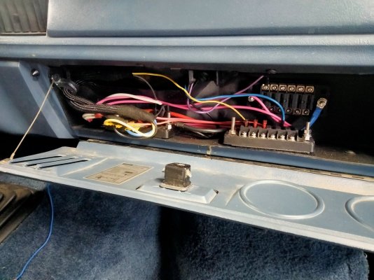

Worked on the wiring some, still learning how to do vehicle wiring cleanly. It's a work in progress. Somewhat complicated because the supercapacitor hooked up to the starter requires that my second battery be separate for the glow plugs. System works really well, fires up immediately, faster than many of the videos I've seen on Youtube.

Injectors, agree, that’s one of those things that you realize is reasonably priced to pay someone else to do.
The wiring, I would think of some way to make a plastic cover for your under the hood panels. There’s alot of opportunities there that you can easily have a wrench or object touch between chassis ground and hot and turn into a glow stick

I agree on covering wiring, I had to be aware of where I left my wrenches when timing it. I'm looking at redoing it a third time so that I am satisfied while also enclosing it all in some sort of waterproof box. It's been a learning experience for sure!
