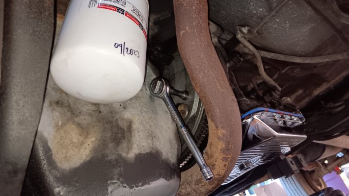

*In the attached photo - is the bolt marked where the socket wrench is inserted the drain plug? (I know it's not right at the bottom, but I couldn't get it there. I started loosening the bolt but had second thoughts and retightened it....). We're looking from the front of the truck to the back in the photo.
*If I can't find a drain bolt/there isn't one, is it the end of the world if I potentially mix transmission fluid types? I'm going to add Mercon V but don't know what is already in there.
*If I can't drain the torque converter, do I just replace the few quarts I removed from the pan (via the dipstick tube) and it will make its way to the pan?

I am not super knowledgeable on the automatic transmissions, but my understanding is that, with the inspection cover off, rotate the engine by hand with a breaker bar or something until you see the drain plug. Should be between two bolts on the converter. When I helped a buddy with this it was on a 460, they may be entirely different.
3,375
3,865
I really don't think there's a torque converter drain plug on a C6. And yes, you just fill it up in the dip stick tube.
Edit: it's not the end of the world if you mix a little tranny fluid. I'm of the old school that says that you don't change automatic transmission fluid (I'll receive criticism for that) in my opinion, since you're adding fresh fluid to an old transmission the clutches will start to deteriorate a little quicker. This is how I was taught in auto shop when I built transmissions everyday for two school years.......... and made my shop teachers lots of $$$$ and I got nothing!
I'd guess you were probably working on an E4OD not a C6.

Maybe they do, I can't picture it. And you can do a E40D in a bullnose.

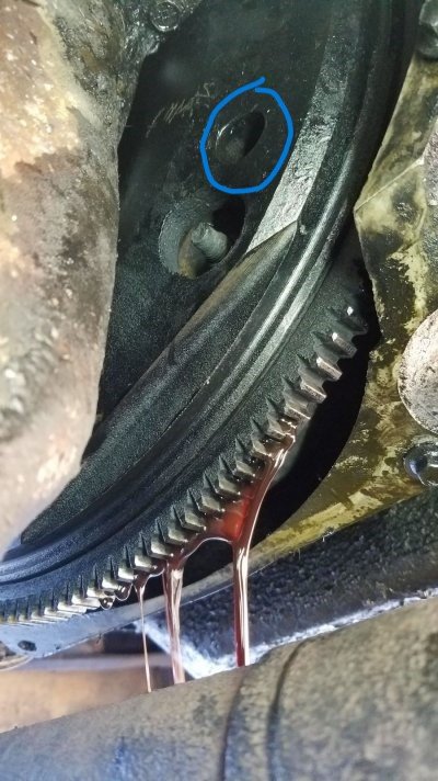

Cubey, thank you. Do you mean the area I circled in your photo? Maybe being overcautious but when I began loosening it, nothing drained out....
If so, I'll be pulling it out tomorrow morning and will report back.......
KansasIDI - thanks, but I don't see a drain plug between two bolts, I'm afraid.
Either way, thanks again, all.
Edit: Comparing it to my initial photo, the circled area does seem to correspond. Much appreciated.

When you get the bolt out, rotate it to the bottom to get the most fluid out.

Yes, circled is correct. The plug needs to be fully removed to see any drainage, partly loosening won't let any out. Biggest thing is make sure you don't cross thread putting it back.

Thanks for the help, all. Managed to locate and remove the torque converter drain plug thanks to the assistance here. I couldn't fit a socket on with it right at the bottom so kept it to one side in the 4 o'clock position but based on the amount of fluid I had to replace I'm guessing I got the vast majority of it out. Only had time to take the truck for a short run (to my horror it wouldn't engage gears at first until I realised the fluid level was still a couple quarts low...) but on this short drive it seemed to shift just fine after I topped it up. Longer test coming up tomorrow to get it fully up to temperature (which takes forever on these systems) and double-check the fluid level, leaks etc.
