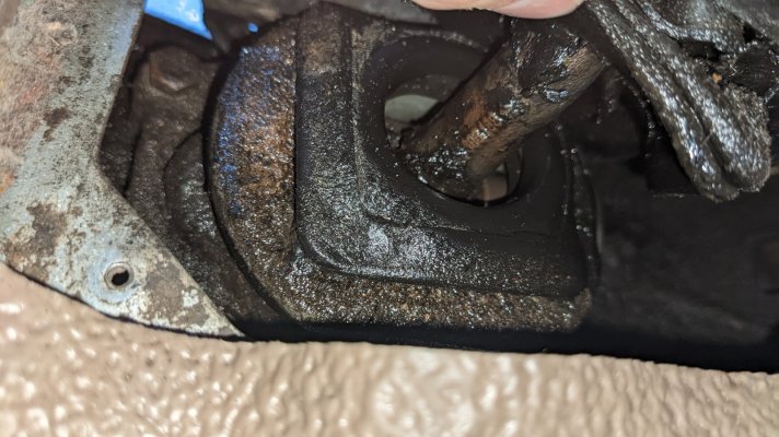

As per title, my transmission is leaking from up top some where. It comes down the passager side. Started shifting hard so I'm changing the fluid today with Motorcraft Mercon V. I'd rather use Redline MT-90 but not going to put expensive **** in the trans just for it too leak out..... Is it possible it's leaking from the shifter itself? Its wet all around with trans fluid, or can it be coming from further up and wind is blowing it there? Picture attached.

Quite filthy and seems likely this is the source of leak. When I pour the ATF in, can I pour it right into this hole? Or do I need to pull something else off to fill it from the top?
Anyone have part numbers? These are nasty and broken, do these hold transmission fluid? Never-Have-I-Ether

If you pour the fluid down the top like that, it seems to me that youll be washing dust and grime into the tranny case. I don't have part #s but I would recommend replacing the shifter bushings while you're that far in. I'm sure that's your "leak" though, there's no pump just spinning gears that sling fluid around.

I'll definitely be wiping it clean before sealing it up. Found the part on eBay. It's called a rubber inner boot.

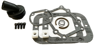

Yup that torn stub boot is the source of your leak. It’s $20 on ammazon. Allstate gear has a whole shifter rebuild kit with the plastic shift bushings, gaskets, and that boot for $30. I just ordered the kit, here’s the link:

Where are the gaskets used?

You’ll probably only be concerned with the small oval one, it goes under the metal plate/top cover that the stub boot attaches to (the one covered with grime in your picture). The medium gasket goes between the shifter housing and the bellhousing, and the two big ones are for your PTO covers. IIRC the metal plate takes a 5mm Allen to remove the 4 screws.

If you have the shifter removed, then you can add the ATF through that hole. It's a lot easier and less messy doing it that way.

I just added a quart from the top without removing it. There IS GRIME inside it unfortunately, and I'm worried how much is in the transmission already.
So, I added a quart because I know I'm low to play it safe. Then I'm ordering a shift boot kit and will replace the bushings and grommet while I'm at it. Then I'll change the transmission fluid and hope that most of the dirt is out. I put cling wrap around the old rubber to keep dirt out for the next several days.
