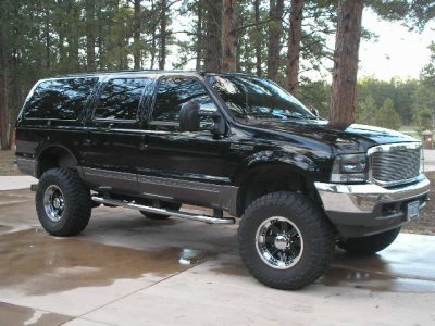

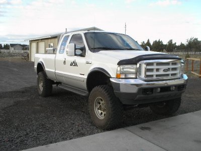

I'll be at Truck Fest... Look for one if not both of our trucks... See my sig, the only thing I am adding is the cardiac arrest HPOP system when its out.
