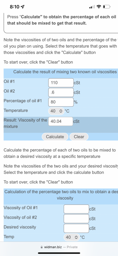

Matching the viscosity of diesel fuel seems important considering injector flow. So I found an online calculator where you can mix oils and it will give you the final viscosity.
My question is, does this seem right? At around 100 degrees Fahrenheit mixing gas (.6 cSt) and 15w40 engine oil (110 cSt) would produce a final viscosity of around 40 cSt. For comparison #2 diesel fuel is around 3 cSt.
Making the wmo / gas mix 13x more viscous than diesel fuel. Is this ok? Will injectors be able to handle the difference?

I’m no expert here, but the formula that that calculator uses may not be very accurate for what you’re trying to figure out. If the formula is just averaging the viscosities based on the ratio, it’s ignoring the solvent effects of the gasoline. It would be pretty easy to perform some tests to determine the viscosity on your own. The actual numbers don’t matter, if all you’re wanting to do is get relatively close to the viscosity of diesel. I’ll add a video to show you the “right” way, but you could easily perform the same test by poking a hole in a soup can with a nail, and timing it with a stop watch. Use the time it takes for diesel fuel as your target, and alter your mix to get closer.
That video was great, pretty easy to test. I wonder if anyone has tried it before on here?
