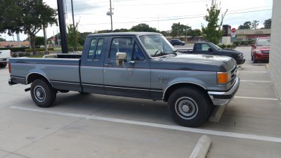

Hey yall this is my first time posting to the forum but it has been very helpful in the last few weeks. Anyway i have bought a very nice 1988 f250 2wd with a dealer installed banks turbo im the third owner and want to make this truck perfect again. BUT. The motor has a lot of blow by and some fueling issues. I estimate almost 400 or 500 thousand miles on it. I can either try to bandaid this motor while i rebuild another motor with some goodies (better turbo arp head bolts bull moose pump etc). or try to restore the motor in the truck now any opinions on it.

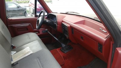

Nice truck...didnt know that silver blue ever came with red interior mines a blue interior.
If you qre confident it will last whike you rebuild one that would likely be best

Im not sure it will last this is my first diesel, from my friend who knows and loves these trucks he said I would I might just go ahead and build a motor. and i believe it was repainted the door jams have a slightly different hue
Welcome to the forum. Nice looking rig too. I'm guessing it has a 5 speed trans. Do you know what type Banks turbo is on the engine? They made 3 different types and the last one is the better type. Its called the Banks waste gated sidewinder turbo. Blow by can be from several different issues but for the mileage it may be showing some age too. Might want to change the CDR valve. That allows the blow by to be sucked back into the intake. How do you know this engine has this many miles on it?

have another block in the works while enjoying what you have for now.

god that is a clean interior! dont look like a 400k mile interior to me!
