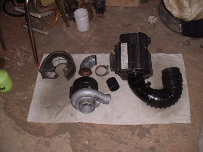

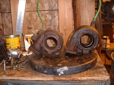

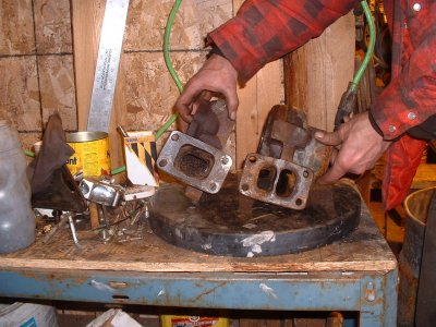

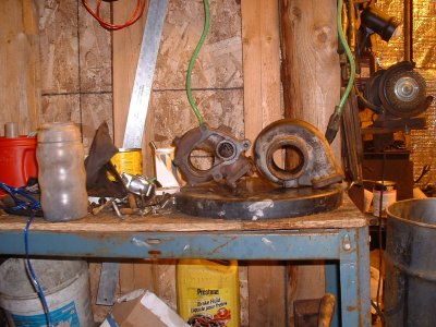

you would be much better off to scrap the gm turbo garbage a put on a holset Wh1c or a hx-35, both require a bit of work but are night and day.... the gm turbo is about 2 sizes too small, so at 2500 + rpms all it does is hit a back pressure wall and pump heat... this is the biggest reason that the 6.5l crack mains and blow head gaskets.... to install the holset you will need to buy or build a new un-crushed downpipe ( look close if it is the OEM, you will be shocked) and then a shorty adapter from gm to holset( or just build a holset specific down-pipe)... cut about 3/4" off the intake hat, buy the oil line adapter, and cut the oil drain pipe and replace the section in the center with a short piece of hose outside the exhaust manifold, and change to a 4" filter and inlet... here are some comparison pictures of the holset and the gm-x turbo housings... the first pic is what the kit looks like to swap when you have the gm downpipe...
