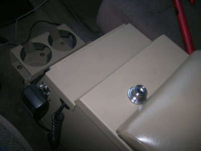

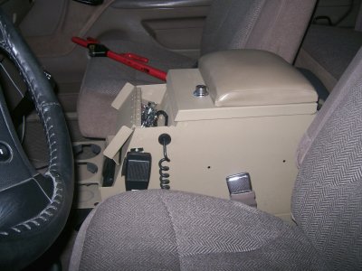

now to fill that empty space between the seats. I couldn't find a tuffy box over 12" wide, I have 18" so I dug out the welder and scrap steel.
first step, mock up something and make sure it clears the shifter and sits high enough to be a comfortable arm rest
cutting, cleaning and priming
starting to come together
test fit
padded top, radio installed
done! locks installed, even included cup holders, extra cigarette lighter plugs and a 110v outlet wired to an inverter behind the seat
