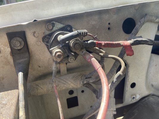

Which wire is it?

It is the top wire with the plastic (rubber?) cover.
DaveBen
Sep 29, 2010
1,928
645
Ukiah, Ca
That solenoid looks funny. The left wire on the big terminal (bolt) is the wire going to the starter, when engaged. It is NOT capable of the current required to start a diesel motor. It should be at least 8 ga or bigger.

Well you may be right and I’ll look at that, but apparently in the process of removing the light, the battery terminals decided they didn’t like their connection and after some cleaning with a steel brush, it’s working again. Weird how that works out but my terminals needed to be cleaned so that works out. Thanks for the help, I’ll definitely look at that wire. Wouldn’t hurt to beef it up with a bigger wire whether it needs it or not.

I would suggest you pull those wires off the starter solenoid and wire brush them. (Unhook the batteries first.) They look questionable, that is the wiring that feeds the glow plugs, the fuse box, takes a charge from the alt, and runs back to charge the batteries.
Two yellow ones are the glow plug fusible links.
The one with the red tape I believe feeds the fuse box in the cab for all your electrical in/on the cab. If you keep having issues unravel that red tape and see if something bad is lurking under there.
Guessing the big red one goes to the batteries.
