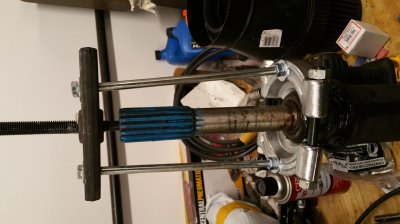

I have a harbor freight bearing puller set. Once I cut the rubber off it came off easily.
The bearing slides right over the splines to.

I used the harbor freight bearing puller too with some all thread extensions. To put it back on I used a piece of 12 or so 1 1/2 galvanized pipe with a cap threaded on. Fit perfectly.

Oh yeah i didnt realize i attached the pic without the all thread i used, i used some longer bolts first to pull the sleeve off
