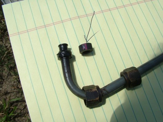

As IDIBRONCO says, sometimes you can tighten the nut a bit and stop a leak, but it's usually only a temporary fix. The olives get old, and they become brittle. They take the shape of the fitting they're in. Any movement is more likely to cause a leak than to fix one.
Here is a picture of an olive on a hard line. Next to it is a new olive, about to be installed. Note the shape of the olive on the hard line. It was once new and pristine, like it's replacement.
1,687
1,669
Here is the Hard Line delete line from Filter to Injection Pump.
You also can replace the hard Line from Lift Pump to Filter with a rubber hose.
Some times those old Olives almost have to be burned out
they have become so old and hard..
