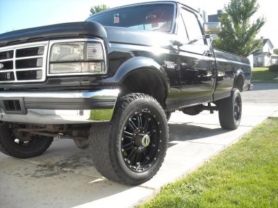

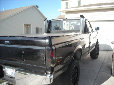

Hey I am new to the oilburners society but I have been scavenging other forums for a while and this looks to be the spot for me. My truck I got about a year ago to get my toys to the dunes and now its my daily driver. 1993 7.3 with ATS turbo. Its got about 218000 on it with the STOCK transmission and motor. The clutch has been changed but not by me. My truck runs great except for a couple things that need smoothing out. (Ill get to those after I make my way through all the 7.3 forums.) So far I have done small things mainly cosmetic for my truck. I did find a set of six inch stacks in a COMPLETE kit for $70 here in town so I couldnt pass them up. I also put new smoked headlights on and I bought some clear lense tail lights and put some smoke tint over them. My truck is black so It really set it off. I painted the interior of the grill black and it made it look ten years newer. I got a set of black wheels and threw them on and now I am looking to raise it up. I am thinking about a four inch kit becuase I want to raise it up with out having to replace the drive lines or tweak the axels but I also dont want to jeoprodize my transmission. What are your thoughts on lift kits? Any economic tips would be greatly appreciated as I now have a baby boy.

Nice truck, and welcome to OB! Gosh... lift kit for our vintage trucks. Can one still be bought? I'm not even sure. Go for it if you can find one. ;Sweet
