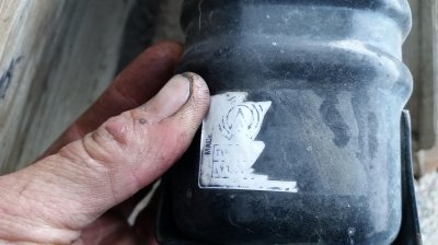

As a matter of fact I did and I recall a decal said chec...its partly gone but the funky symbol is still there see..
No idea how good or bad rad is...seems decent...came with 93 reg cab 4x aka crippled hippo...
