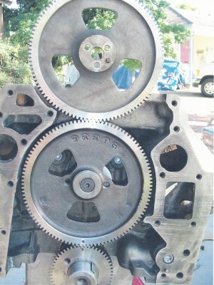

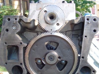

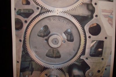

First off you need an injection pump and injectors. then you need it timed. With 3.55 gear and an auto trans you will have issues hauling the load you posted. When you removed the injection pump gear cover and "checked the gear timing". Did you find the Dot and the Y timing mark in the cam gear? If you mixed them up you will be 180 degrees out of gear time and it will run but poorly. Here is what the gear timing looks like.
