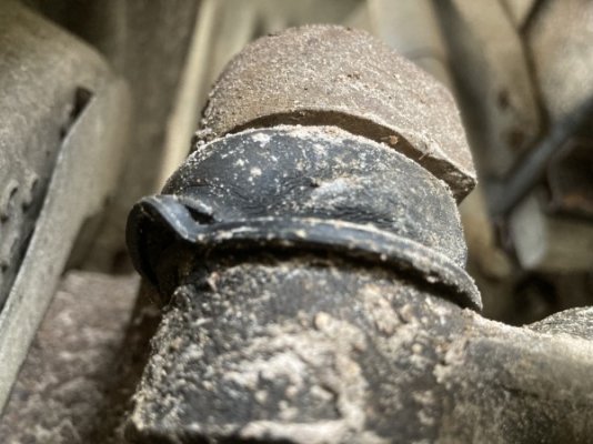

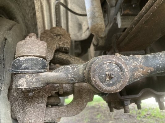

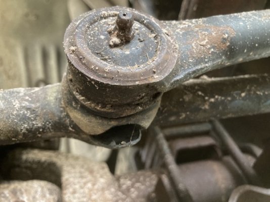

In order to pass the annual inspection, I need to change these rubbers on the steering gear, anyone here knows how? and where to get them?(if possible?)

Not sure what your options are over there. Here any parts store that has Dorman products usually has them in stock.
As for removal I would recommend a press type remover, pickle fork puts alot of stress on the ball socket.

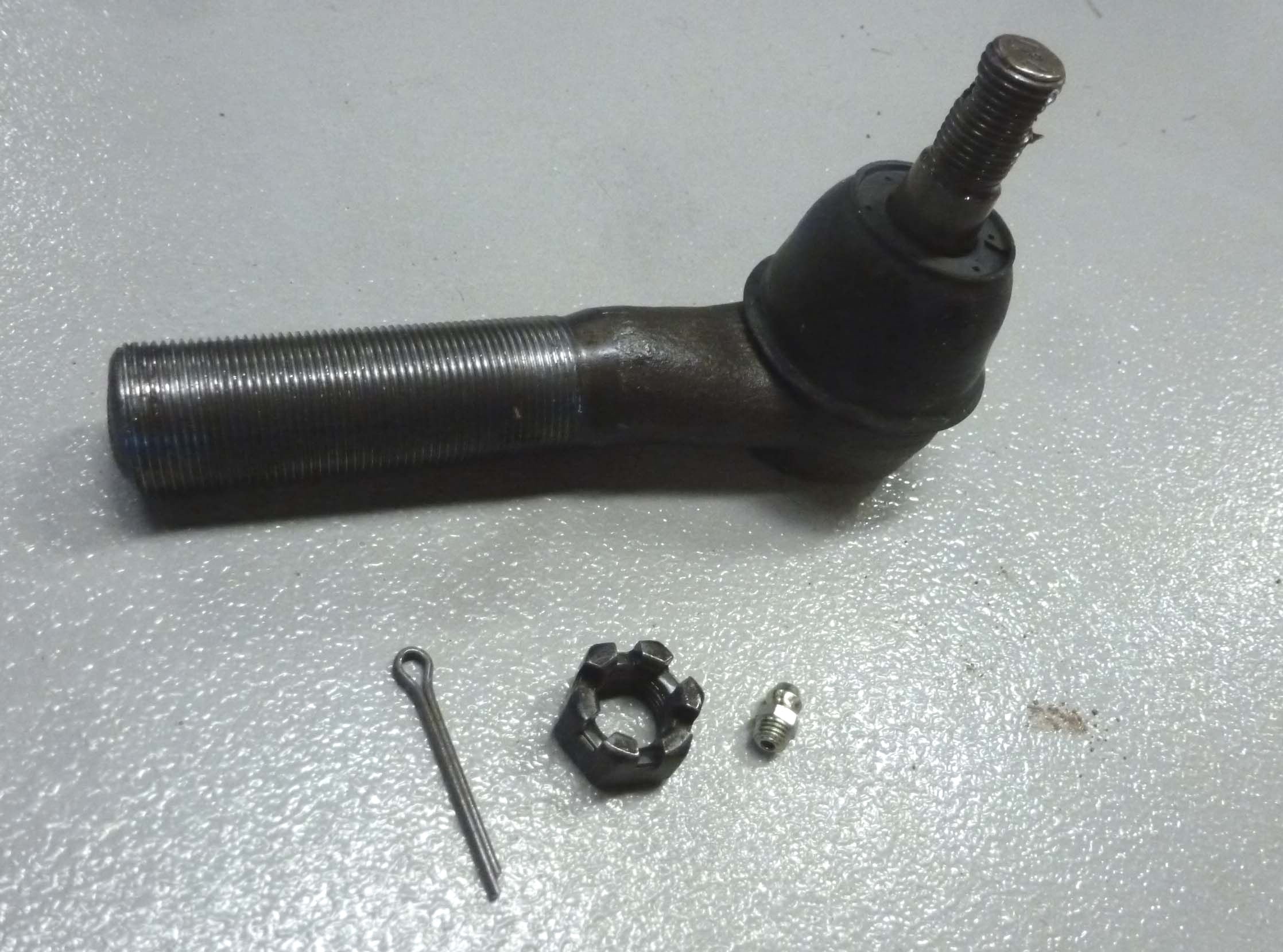

Are these the outer tie rods or drag link? Am not familiar with the D60 but have been looking into equivalent steering components for the D50 ttb. The steering components are relatively cheap - like $15-40 USD from a website like LMC Truck [1]. Others on here will definitely be more knowledgable than myself but believe the joints/rubbers are not offered separate from the tie rods. You may be able to find the parts on ebay since shipping to France might be a limiting factor

Additionally Bronco Graveyard carries these parts and is a good website - LMC just happens to be the cheapest I have seen

you mean for the rubbers? My truck only has 10.000 miles, the joints are still ok, it's only that these rubbers are about shot due to age.

They will get you by in a pinch, from my experience the rubber they use tends to fail quickly.

When I buy various parts from the autoparts stores, some of them come with these plastic plugs on the ports. I always save these in a bin, they come in handy to keep things from leaking and keeping the dirt out of stuff. I too have found the Dorman rubbers don't last that long. But I have taken the larger ones of these plastic plugs, cut a hole in the middle, and slipped it over the tapered stud of the joint. Just something to hold some grease in and keep the water and dirt out. If you keep them greased, the water and dirt can't get in anyway.
P.S. I only suggest this because I have them laying around and they are free. If you are going to buy something, might as well buy the correct thing.

Hmmm, Today I passed the technical control, with a side note, I've one month to replace these joints, they have such a hydraulic steering violator, and that made clear all my steering joints need replacing.
does anyone here know if I can press them out and replace? or just replace the whole bar? (which will be hell on shipping to Europe !)

Google: "tie rod end" boot
Lots of options.
Its a dumb thing to fail you on because they are mostly cosmetic. Grease more frequently to keep dirt and grit out.
