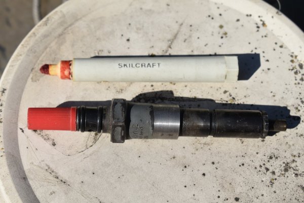

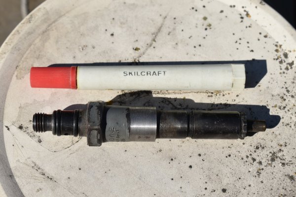

Periodically we read about people having problems sliding the o-rings into position on their injectors, nicking the rubber and causing subsequent leaks. Getting them past the threaded portion of the injector seems to present a challenge. I've recently remembered a method Calvin taught me a number of years ago.
I use the cap from a government issued felt tip marker. Yes, government issued equipment does have it's uses. It slips on the injector to cover the threads. Grease it and the o-ring and that o-ring slides right on. You might even sand it down a bit to take the edge off the grooves on the cap. I suggest that you install the closest o-ring first, and let the second o-ring slid right over the first.
And since we all love and understand pictures:

Well I didn't know or think to use anything to cover the threads on the 1st go-around. And so I have a few leakers.
I got some more o-rings today and used a Carmex lip balm cap to cover the threads while putting the new o-rings on. I only had time to do one injector but it seems to be dry now. I'll stick with this method.
Thanks for the tip.
